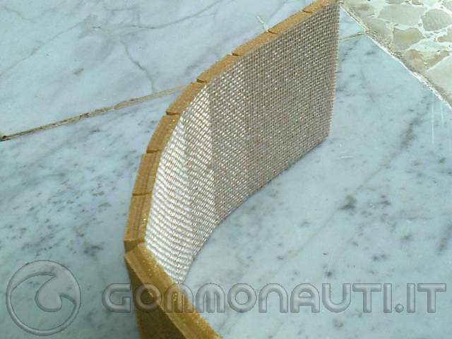

Termanto
[YOUTUBE]https://www.youtube.com/watch?v=EB3LzKCRbXI[/YOUTUBE]

Termanto quadrettato, adatto a curve strette
