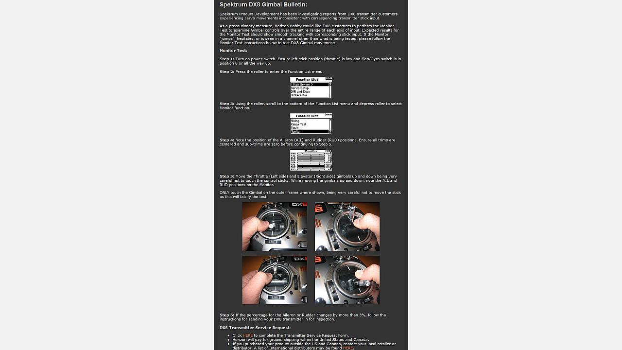

Ciao a tutti,
c'è un bollettino che indica che alcune radio potrebbero avere problemi.
Sotto un estratto
Spektrum DX8 Gimbal Bulletin:
Spektrum Product Development has been investigating reports from DX8 transmitter customers experiencing servo movements inconsistent with corresponding transmitter stick input.
As a precautionary measure, Horizon Hobby would like DX8 customers to perform the Monitor Test to examine Gimbal controls over the entire range of each axis of input. Expected results for the Monitor Test should show smooth tracking with corresponding stick input. If the Monitor "jumps", hesitates, or is seen in a channel other than what is being tested, please follow the Monitor Test instructions below to test DX8 Gimbal movement:.........
