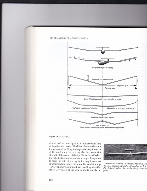

https://i.postimg.cc/T1xxrz82/IMG-20240107-0001.jpg

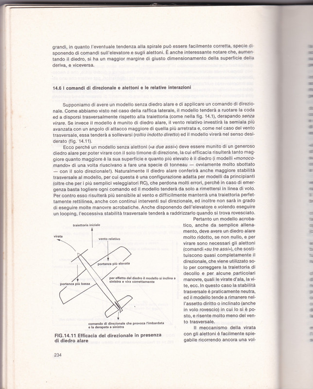

https://i.postimg.cc/xdbVBfnT/IMG-20240107-0002.jpg
