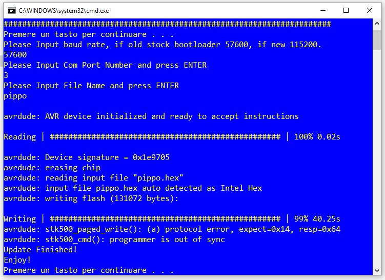

nel mio caso (Anet 1.0) la scrittura non va a buon fine e dopo il fallimento la scheda anet va in brick. Codice: Please Input baud rate, if old stock bootloader 57600, if new 115200. and press ENTER 57600 Please Input Com Port Number and press ENTER 16 Please Input only File Name and press ENTER Firmware1.1 avrdude: AVR device initialized and ready to accept instructions Reading | ################################################## | 100% 0.00s avrdude: Device signature = 0x1e9705 avrdude: erasing chip avrdude: reading input file "Firmware1.1.hex" avrdude: input file Firmware1.1.hex auto detected as Intel Hex avrdude: writing flash (128916 bytes): Writing | ################################################## | 100% 29.92s avrdude: 128916 bytes of flash written avrdude: verifying flash memory against Firmware1.1.hex: avrdude: load data flash data from input file Firmware1.1.hex: avrdude: input file Firmware1.1.hex auto detected as Intel Hex avrdude: input file Firmware1.1.hex contains 128916 bytes avrdude: reading on-chip flash data: Reading | ################################################## | 100% 25.24s avrdude: verifying ... avrdude: verification error, first mismatch at byte 0x1f000 0x9f != 0x0c avrdude: verification error; content mismatch avrdude: safemode: Fuses OK avrdude done. Thank you. Update Finished! Enjoy! è possibile avere i sorgenti? |
